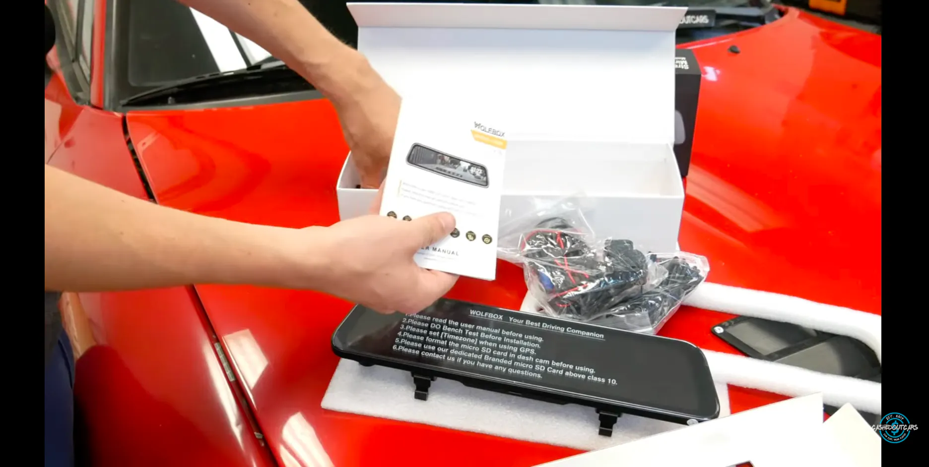

Step 1: Mounting the Mirror Unit

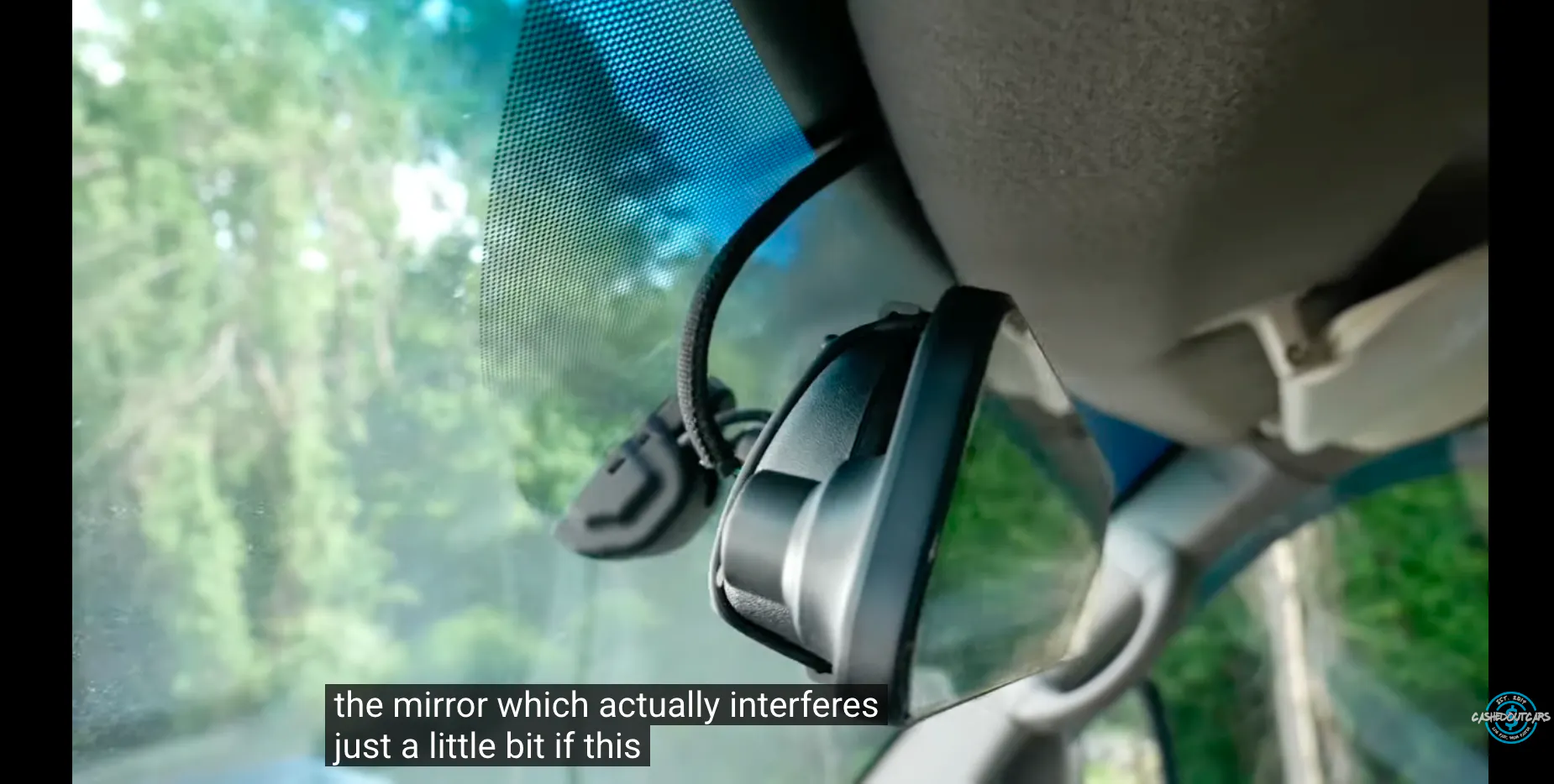

The G840S straps directly over your existing rear-view mirror, making it a universal fit for most vehicles.
  • Positioning: Place the Wolfbox unit over your factory mirror.
  • Adjustment: The front-facing lens is on the left side. If it hits your original mirror, slide the Wolfbox unit slightly to the side to clear the obstruction.
  • Secure It: Use the included rubber straps to strap it down firmly around the back of your original mirror.

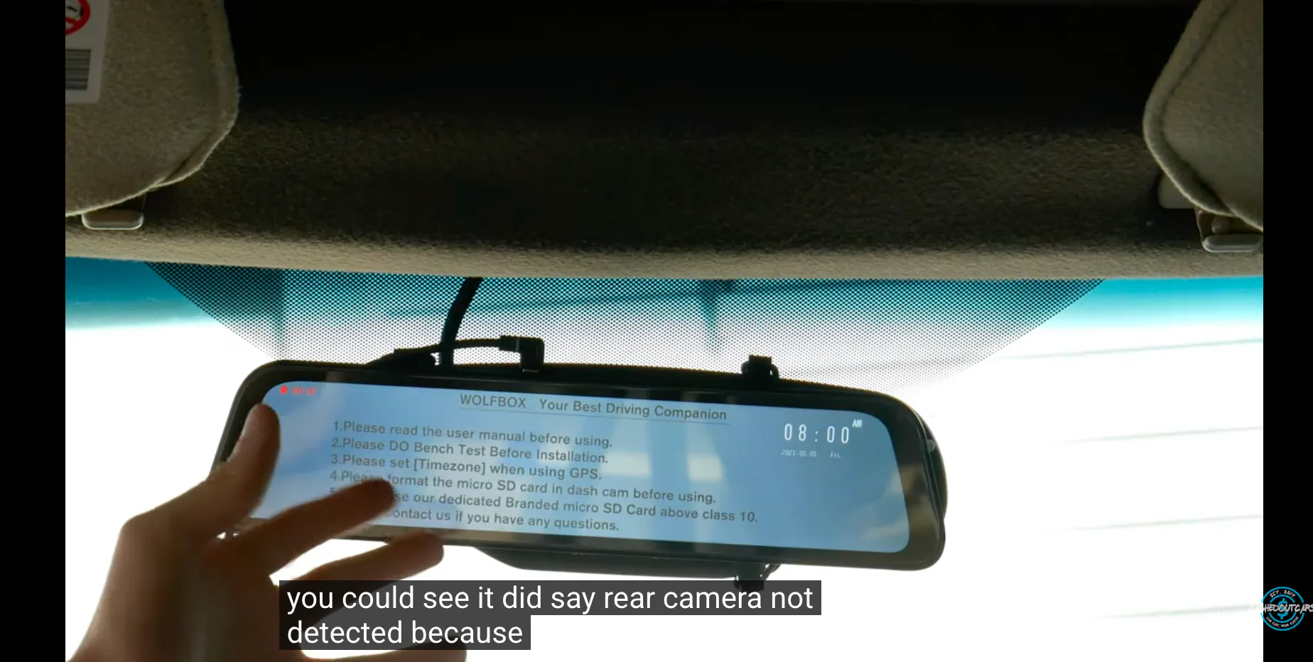

Step 2: Initial Power Test
Before you spend hours hiding wires, always test the system first to ensure everything works!
  • Plug & Play: Connect the power cable to the unit and plug the adapter into your car's cigarette lighter port.
  • Verify: Turn the car on to ensure the screen powers up.

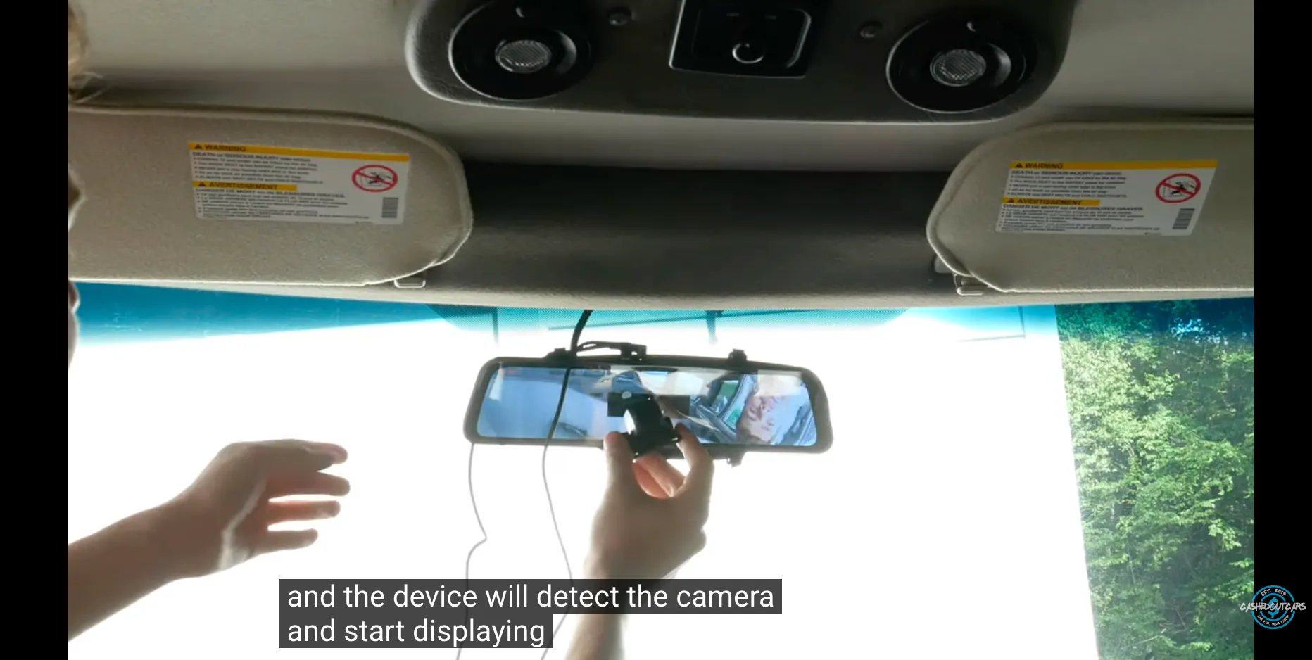

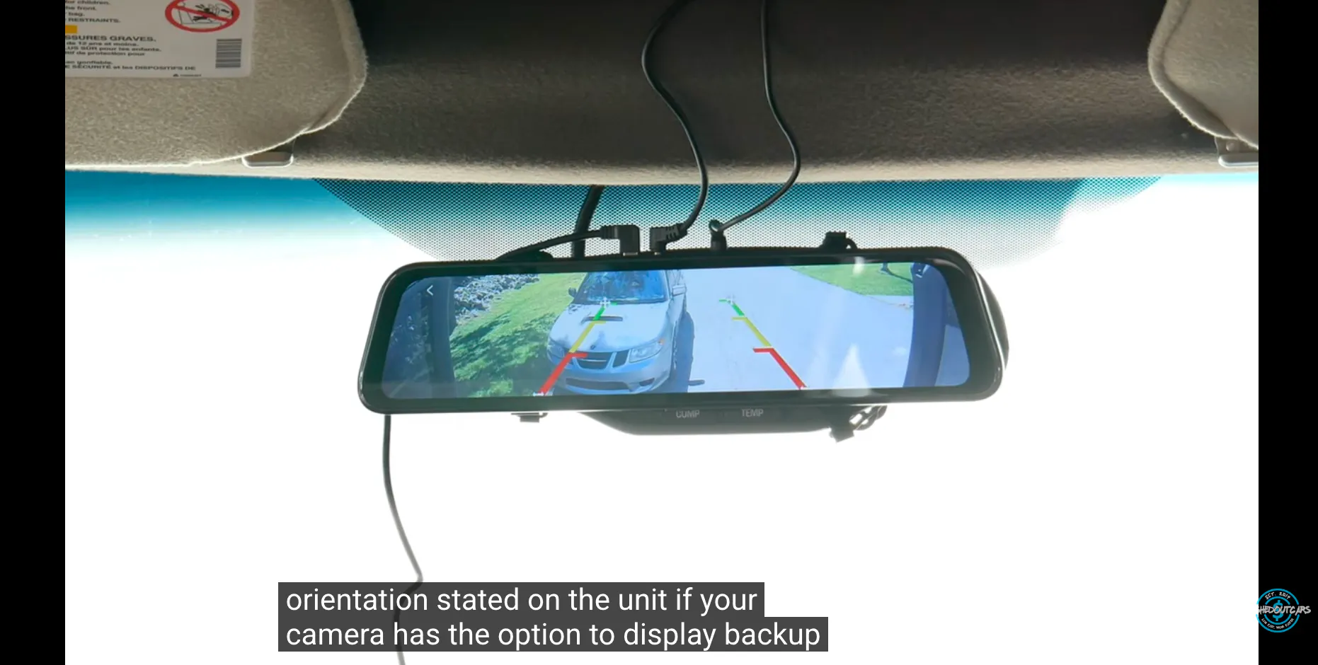

Step 3: Rear Camera Connection & Test
  • Connect: Plug the rear camera cable into the top of the mirror unit (labeled AV IN).
  • Check View: The screen should automatically switch to the rear view.
  • Orientation: Make sure the image is right-side up. If it's upside down, flip the camera unit itself before you mount it.

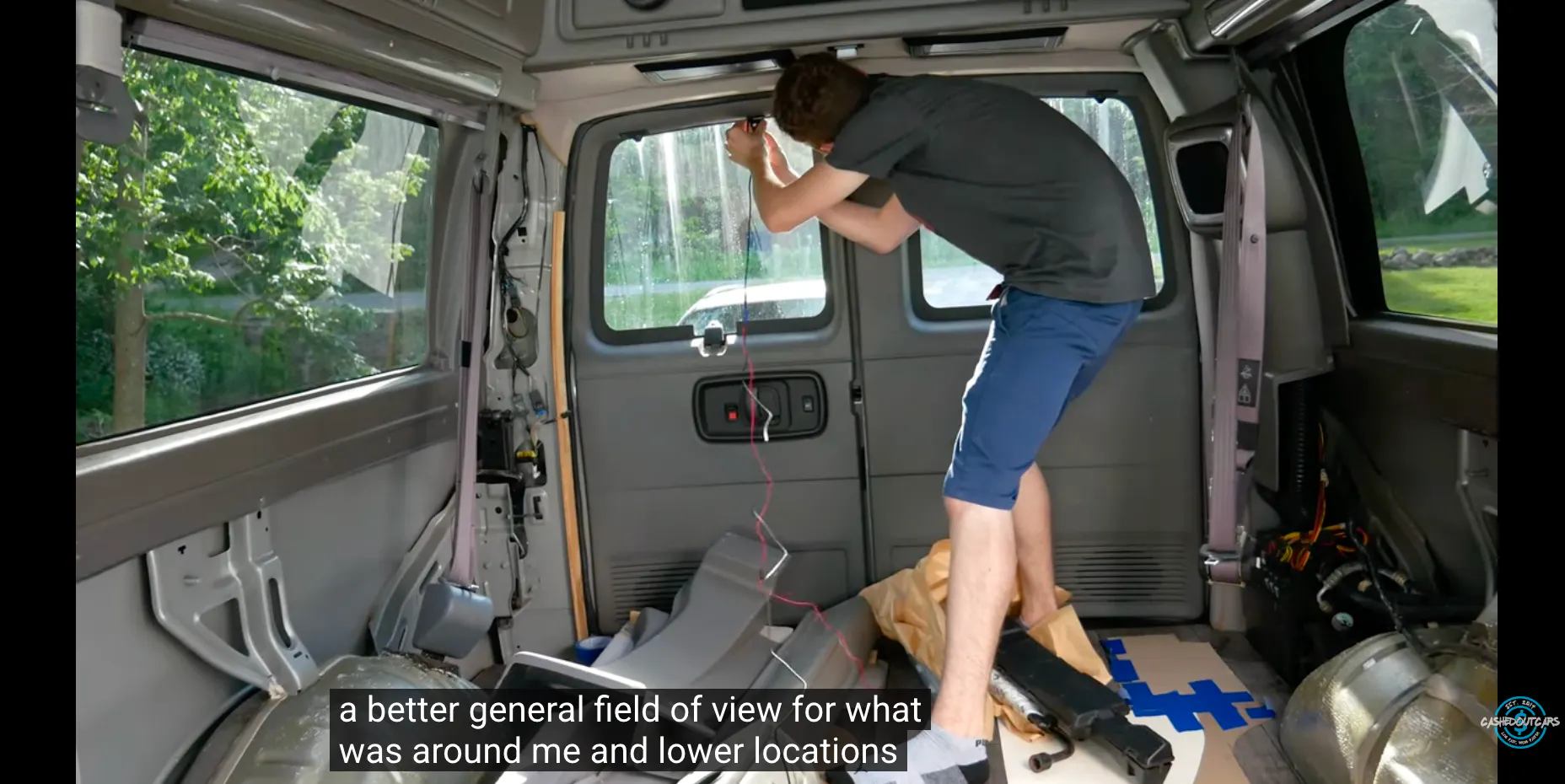

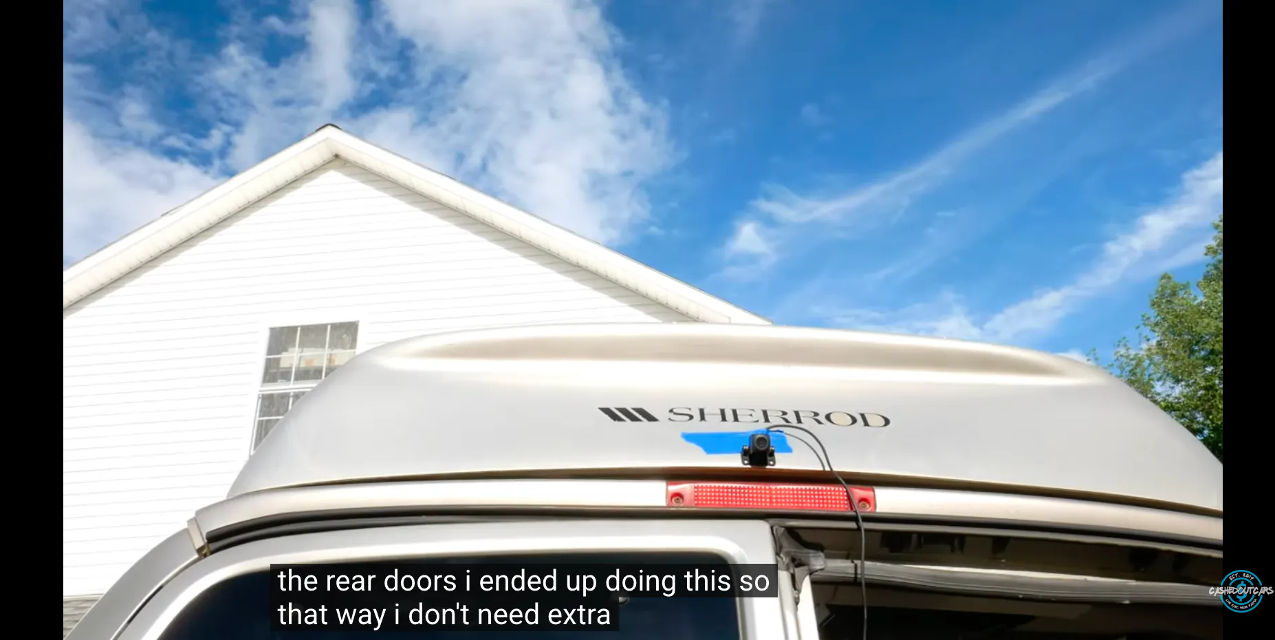

Step 4: Mounting the Rear Camera
You have two main options for placement: High (better field of view) or Low (better for backing up to trailers).
  • Location: In this video, we mounted it outside the vehicle, above the rear doors (on a van) for a wide, clear view.
  • Clean & Stick: Clean the mounting surface thoroughly with alcohol. Use the provided double-sided tape (or screws) to secure the camera.
  • Pro Tip: Mounting it high up often prevents the camera from getting dirty as quickly as mounting it near the license plate.

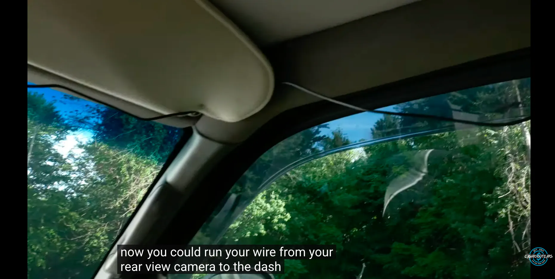

  • Tuck It: Use the orange pry tool included in the kit to push the wire into the gap between the headliner and the roof trim.
  • Weather Stripping: Gently pull down the rubber weather stripping on your door frames. You can run the wire inside these pillars and then push the rubber back in for a seamless look.
  • Route to Rear: Continue running the wire all the way to the back of the vehicle to connect to the rear camera.

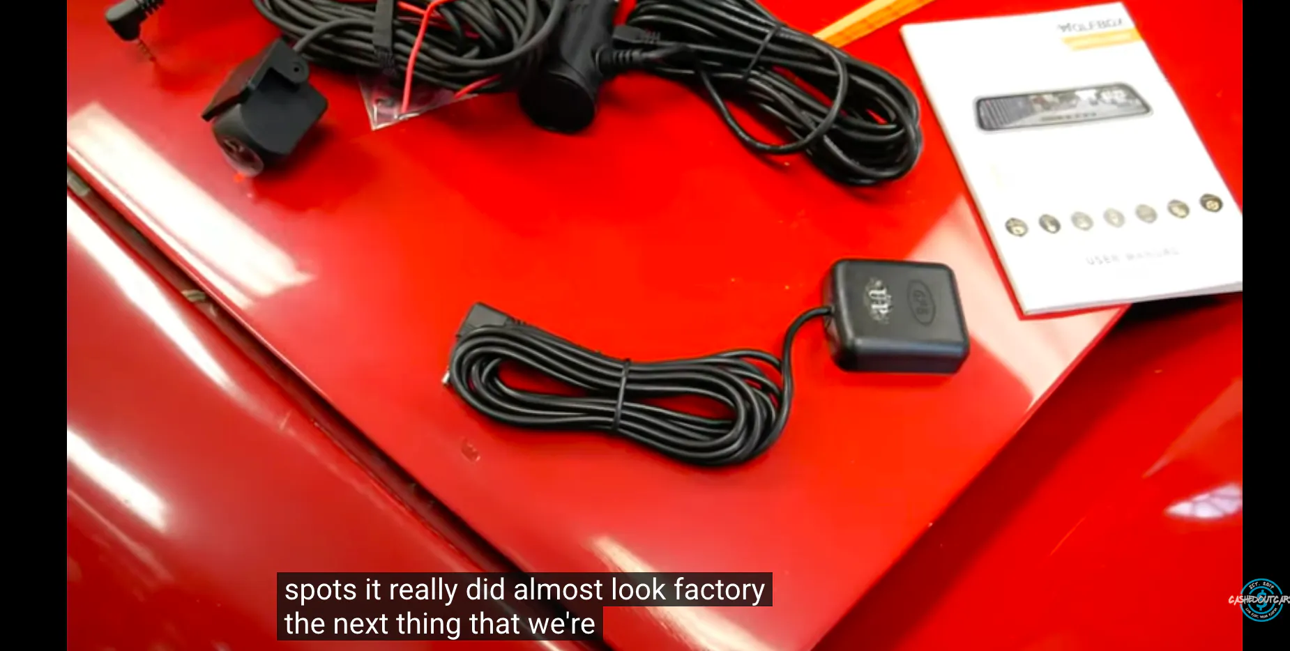

Step 6: GPS Module Installation
The GPS module records your speed and location data, which can be vital for insurance claims.
  • Connect: Plug the GPS into the GPS port on the top of the mirror.
  • Mount: Stick the module to your dashboard or the top of your windshield.
  • Signal: Ensure the side indicated ("GPS" or logo side) faces up towards the sky for the best signal reception.

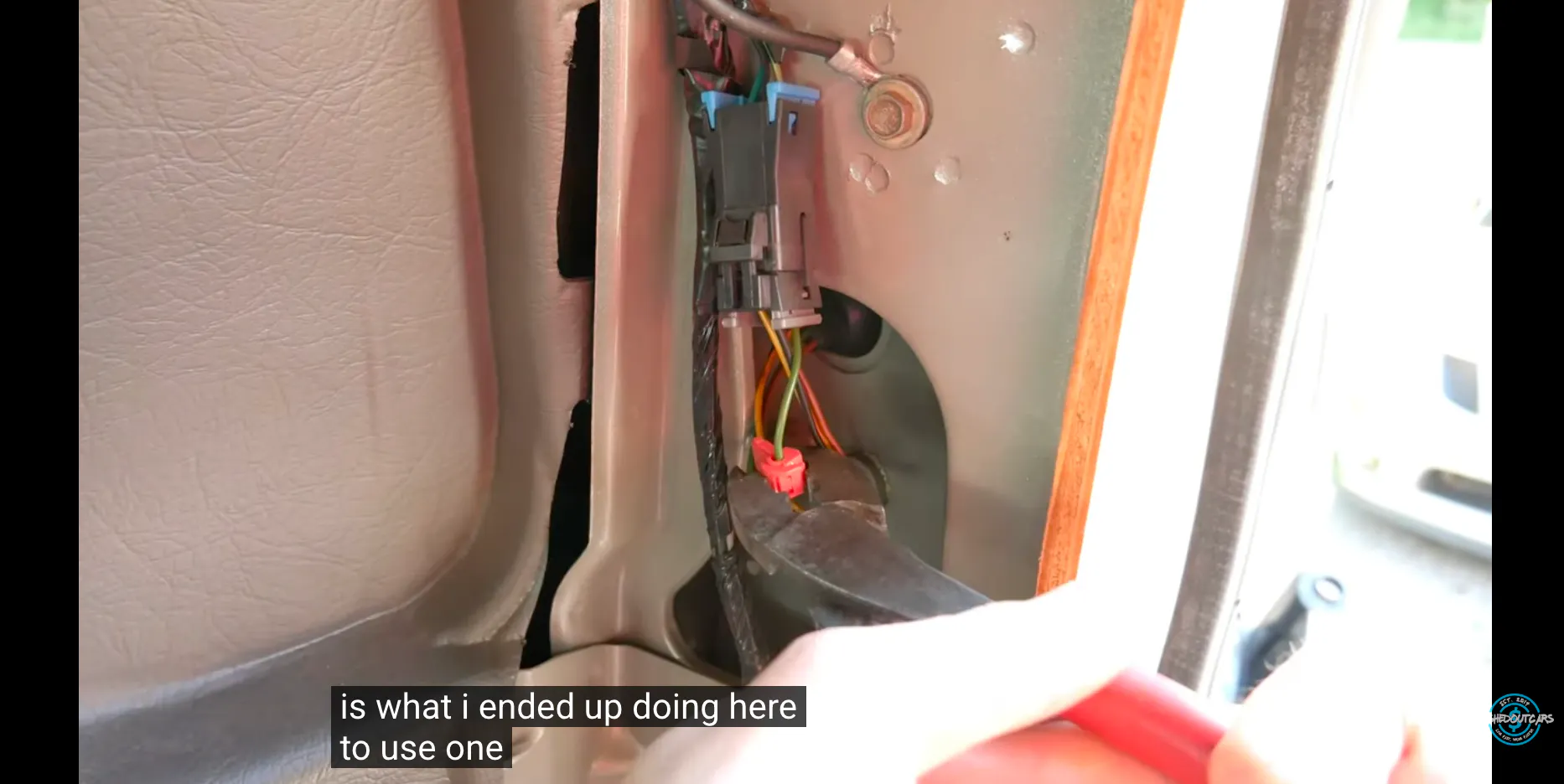

Step 7: Reverse Light Trigger (Red Wire)
If you want automatic parking lines when you reverse, you must connect the Red Trigger Wire.
  • Find the Circuit: Locate the positive wire for your reverse lights (either at the tail light bulb or in the vehicle wiring harness).
  • Splice: Use a "T-splice" or tap connector to attach the Red Wire from the rear camera cable to the vehicle's positive reverse light wire.
  • Result: Now, whenever you shift into Reverse, the screen will automatically show parking guidelines. (Note: The user in the video preferred the wide view without lines, so he unplugged this, but the steps are here if you want it!)

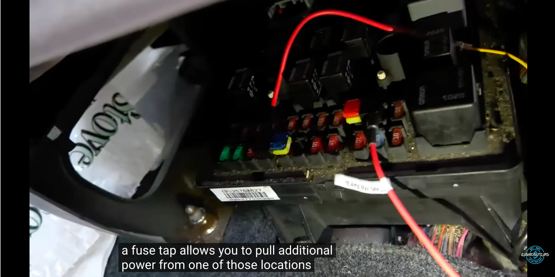

Step 8: Hardwire Kit (Parking Mode)
To enable 24-hour parking monitoring (time-lapse) and free up your cigarette lighter socket, use the Wolfbox Hardwire Kit.
  • The 3 Wires:
    1. Ground (Black): Connect to a solid metal bolt on the vehicle's chassis (unpainted metal is best).
    2. Switched Power (ACC - Red): Use a fuse tap to connect to a fuse that turns on/off with the key (e.g., radio, wipers).
    3. Constant Power (Batt+ - Yellow): Use a fuse tap to connect to a fuse that always has power (e.g., horn, headlights).
  • Function: This allows the camera to record a low-power time-lapse while parked and wake up fully when you start the car.
