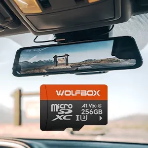

Hardware Baselines
For stable, continuous loop recording without dropped frames or missing files, ensure your hardware matches these baseline specifications:
  • Speed Rating: You must run a U3 / Class 10 rated card. Slower cards cannot handle the high-bitrate video streams, especially on multi-camera setups.
  • Capacity Limits: Do not push past the maximum supported storage size for your specific unit, as the processor will struggle to index the files:
    • G900 PRO: 512GB maximum
    • G840S: 256GB maximum
